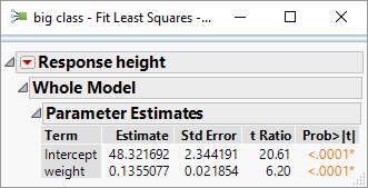

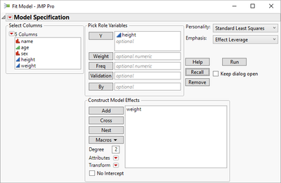

Use the Fit Model platform, rather than the Fit Y by X, and using the options under the Red Triangle, you will be able to unselect all of the unwanted components, including the plot
Jim

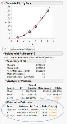

Another option is to launch the analysis in "invisible" mode and then query the report for the values you want to extract using display box subscripting:
biv = Bivariate( Y( :weight ), X( :height ), Fit Polynomial(2), Invisible);
rep = Report(biv);
//all = rep["Parameter Estimates"][TableBox(1)] <<Get As Matrix;
pe = rep["Parameter Estimates"][Number Col Box("Estimate")] <<Get As Matrix;
biv << Close();
show(pe);
