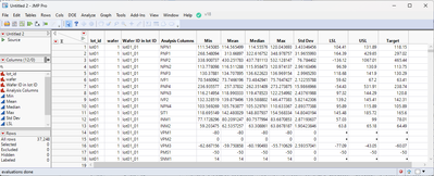

The example script below gets me the 5 number summary in the format I need. However, I would also like to get the spec limits for each parameter (under Analysis Columns) , LSL and USL, in two separate columns in the final "Summary" data table? How to get this via JSL?
Also, is a another/better way to do what I am need without using Tabulate ()?

You can use the Manage Limits system to do what you want

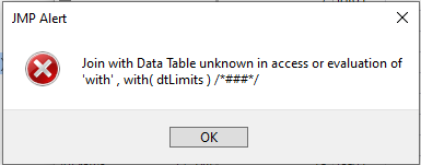

Re: How to get spec limits in separate columns in 5 point summary table?
@jthi Get this error on JMP 16.2
Object 'Data Table' does not recognize the message 'Manage Limits';
perhaps you mean one of these: <<Manage Spec Limits <<Item Analysis <<Factor Analysis <<Combine Columns... <<Make Indicator Columns... <<New Columns... <<Paste Columns <<Markers <<Select Matching Cells <<Get Rows <<Maximize Display <<Move Scripts <<Rename Table Script <<Matched Pairs <<Multivariate <<Normal Mixtures <<Capability <<Parallel Plot. There is no other opened data table to update the current data table. Empty()
Changing Manage Limits () to Manage Spec Limits () gives me another error.

jthi
Maybe this doesn't work in JMP16.2. You have to perform different types of checks for the tables. If I remember correctly Get Data Table List() is fairly robust option and the latest table is always first

txnelson
I changed the code to eliminate the Manage Limits section and to change it to a simple piece of JSL that creates a limit table by reading the limits from the original table.  See if this works
