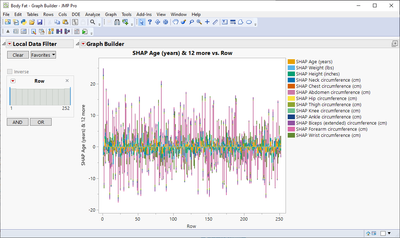

When you add shapley values to your data table you will also get a table script which creates a graph for you
You can change the type if wish to (stacked bar chart (default), stacked line chart, stacked area chart all work on some level).
You could also stack the data and visualize that. If your data doesn't have unique identifier for each row, you might want to create one and then stack the shap columns and keep that unique column. After you have stacked your data, you can create a bit different looking plots, for example
Link Mark provided has some information about the shapley values in JMP and some sources to check out.

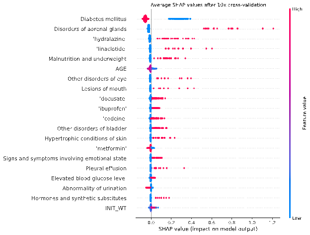

I'm not sure which outputs you mean for graphs. Second plot you provided looks like it could be from shap python package Welcome to the SHAP documentation — SHAP latest documentation and not from JMP (you can get quite similar in JMP but it does require some work). SHAP documentation does also have additional examples you can use ideas how you could plot your data.
After you have your shapley values in your graph, you can start using them in any way you find useful in JMP. Usually I think stacking them is best option, you can find stack platfrom from Tables menu Stack Columns in Data Tables (jmp.com). Stack the shapley value columns (+ feature value and row identifier if you want to) and then start plotting. I would still keep the other format as both of these have their own pros and cons.

Thank you for getting back to me jthi  @jthi . I took a bit of time to play around with the prediction profiler to calculate the shap values on the data table and create a graph. However, I am running into the following problems and wondering if you are able to either give some more insight or share resource that can help answer my questions below:
1) I am evaluating a total of three models, one of them is the boosted tree with smote plus tomek sampling method.
Please see the attached subset of the data (the data is large so I am attaching a subset of it). I ran the shapley values on the prediction profiler, but I did not see the newly calculated shapley values on the data sheet. I also selected to add shapley script to data table, but I did not see it added to the data table. I am wondering if this is possible to do  on the boosted tree? I was able to do this on generalized regression but I also didn't have to create the k fold cross validation for the generalized regression, I did need to do that for boosted tree. I assume with shapley values as an option on the boosted tree, I should be able to see the calculated shapley values on the data table. Some insight will be helpful in trying to figure out why I can't see the calculated shapley values on the data table.
2. How do I go about changing the type of graph outputed? For instance, how do I go about changing the type of graph you presented as an output above to dotted graph? What would I select to change from line graph to dotted graph on the right?
        TO
In the (video) link that you provided, it shows the outputs for the graphs, but they don't show the steps in how they got to those outputs. I am wondering if you can shed some light on how to go about changing the types of graphs, what would I select? Is it the control panel and then select the different types of graphs? When I do this, it changes the outcome totally. Please see attached for a subset of the data table. You mentioned "You can change the type if wish to (stacked bar chart (default), stacked line chart, stacked area chart all work on some level)," where do I go to change the type of stacked graph from the default bar chart to line chart?

Hi Jarmo @jthi ,
You are right about the second plot, it is from shap python package, but I checked out the SHAP documentation that you recommended for additional examples and found it to be helpful in visualizing the data. Thank you for providing the direction in creating the graphs using the stack columns (this is new to me and I explored more to learn about it).
