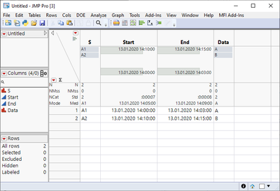

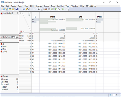

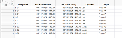

I have a process data table including Start timestamp and End timestamp. I would like that the duration of the process is calculated from the timestamps, and then additional rows are added .Column values of start timestamp are added by increasing the time by 1 minute till the End time is reached. All the other values in the table should be just copied to the next row.

How does your starting data look like (I assume the image is from end result)?
Edit: Other image loaded a bit slower
-Jarmo

Here is one option which might work. It does create a new table instead of adding rows to the existing one

Re: Fill in column values based on a sequence creation relying on table values
@jthi I just tested it with the real data and it works very nicely. Thanks, this is exactly what I wanted to have.
