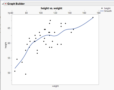

jthi
Re: How to get my x-axis at the top/ above the graph instead of the default setting of x-axis being at the bottom?
I'm not sure if this can be done (easily) in Graph Builder, but you can use journal to achieve at least something similarHow can I move the x-axis on top of graph?
First create graph in graph builder, then go to edit/journal, select x-axis and move it to top of graph. This is a bit hacky solution and doesn't look as nice as graph builder (tick marks for example are in wrong side). You can also move the x-axis title (getting it to center might require some more modifications to display boxes).
You might also be able to modify the margin of x-axis in graph builder but it is dependent on the graph size and most likely even more hacky option.
-Jarmo
Zainab22
Level I
Thanks for the reply. I tried this solution, but as you said it ended up corrupting the graph and doesn't look accurate!
