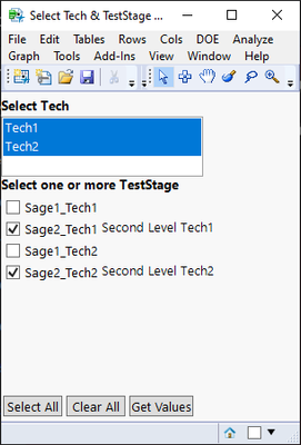

jthi
Re: How to get check boxes to be change (or become visible or active) based on a previous selection in a modal window?
Use associative array to store your different lists, create expressions/functions to create a collector for checkboxes and ifboxes.
This doesn't use modal window, as it is much easier to develop when not using one as you can easily test different gets and such from the script editor

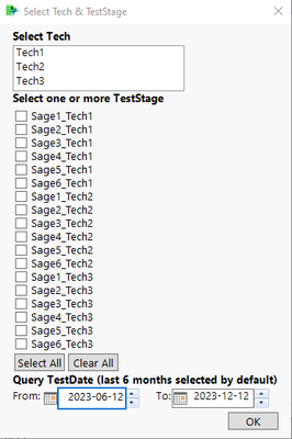

This might give you some ideas what you could do
@jthi Thanks. Running your script starts off by showing all TestStages under TestStage by default (pasted below) and then once a Tech is selected, it behaves as needed.
Could the script be modified to not show nothing first under TestStage selection text and then once the Tech is selected, show the appropriate/available TestStages?
When it's too good to be true, it's neither

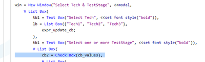

You could initialize the check box with empty list instead of cb_values.
-Jarmo
@jthi  I have already tried with
cb_values = {};
but I think I am not placing this correctly. Where should this statement go?

jthi
This is the place where you set those values first time
also if you want it to be always empty when no selections are done you will also have to make small modification to expr_update_cb
-Jarmo
@jthi . In that case I did place the
cb_values = {};
correctly, but did not do the small modification to expr_update_cb.  Just placing the above line before cb2= Check Box(... does not do what's needed once Tech is selected. Thinking.......

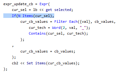

jthi
Initialize Check Box with empty list not cb_values (they are different things).
Within the expression this is the part you have to consider (and understand)
Why is if statement used here? What would happen if we go to else? What would happen if we don't have it, we have an empty list and go to Filter Each?
-Jarmo
@jthi Thanks for the pointers, I tried last night but without success so far.
This is how I understand the requirement, if none of the items are selected in under lb then cb2 should not show. cb2 should show only when N Items(cur_sel) ≥1.
However, expr_update_cb fires only when one or more items are selected in lb.
It is not clear to me how to modify expr_update_cb to be executed when nothing is selected under lb.
Should the requirement of not showing anything under cb2 be handled with an if/else statement around lb i.e. if nothing is selected under lb, do not show cb2?

expr_update_cb = Expr(
	cur_sel = lb << get selected;
	cur_cb_values = Filter Each({val}, cb_values,
		cur_tech = Word(2, val, "_");
		Contains(cur_sel, cur_tech);
	cb2 << Set items(cur_cb_values);
win = New Window("Select Tech & TestStage", <<modal,
	V List Box(
		tb1 = Text Box("Select Tech", <<set font style("bold")),
		lb = List Box({"Tech1", "Tech2", "Tech3"},
			expr_update_cb;
		tb1 = Text Box("Select one or more TestStage", <<set font style("bold")),
		V List Box(
			cb2 = Check Box({}),
			H List Box(
				Button Box("Select All", cb2 << Set All(1)),
				Button Box("Clear All", cb2 << Set All(0))
		tb3 = Text Box(
			"Query TestDate (last 6 months selected by default)",
		end_date = Today();
		start_date = Date Increment(end_date, "month", -6, "actual");
		cb3 = H List Box(
			Text Box("From:"),
			scal = Number Edit Box(
				start_date,
				<<Set Format(Format("yyyy-mm-dd")),
				<<SetFunction(Function({this}, start_date = scal << Get)),
				<<Set Show Spin Box(1)
			Spacer Box(Size(20, 20)),
			Text Box("To:"),
			ecal = Number Edit Box(
				end_date,
				<<SetFunction(Function({this}, end_date = ecal << Get)),
