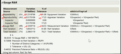

I want to automate the next stage which is getting the Repeatability, Reproducibility and Gauge R&R Variation values (marked with red arrows) for each measured in a new data table
In the video I linked before, this is done post 1.38 mins into the video and is done manually.
How to automate this part via JSL?

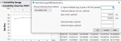

I wouldn't worry about getting the table box if you cannot get gage results (worry about table box later). I don't remember anymore how I did gage scripting in earlier JMP versions (JMP14, 15 and 16), but most likely I did them one by one as it most likely faster if you are only interested in the results and not in the plots. This seemed to work in JMP16.2

@jthi Thanks. This script works in my JMP 16.2 and does not ask me to verify Gauge specifications. Looking at the script for "Make Combined Data Table" for :NPN1, while for I see

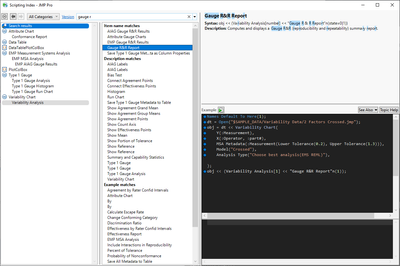

Re: How to get Repeatability, Reproducibility and Gauge R&R Variation values for each parameter in a table post Gauge R&R analysis via JSL?
Build list of columns of interest and then send Gauge R&R Report message
Names Default To Here(1);
dt = Open("$SAMPLE_DATA/Semiconductor Capability.jmp");
var = dt << Variability Chart(
	Y(:NPN1, :PNP1),
	Model("Main Effect"),
	X(:SITE)
var << "Gauge R&R Report"n(1);
