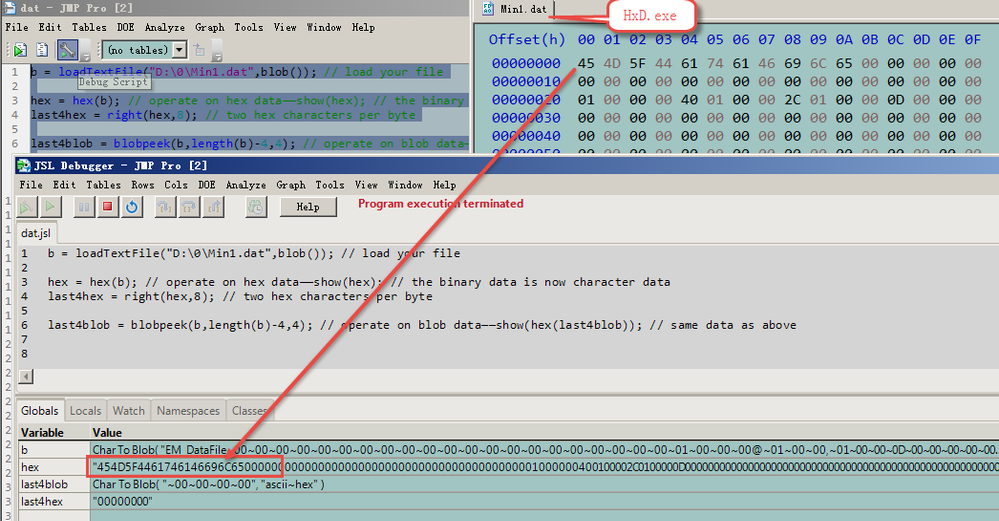

Open "min1.dat" with "HxD x64.Exe to see the specific hexadecimal symbol.
JSL scripts written with Craige can also see this and display the same content.
b = Load Text File( "D:\0\Min1.dat", blob() ); // load your file
hex = Hex( b );

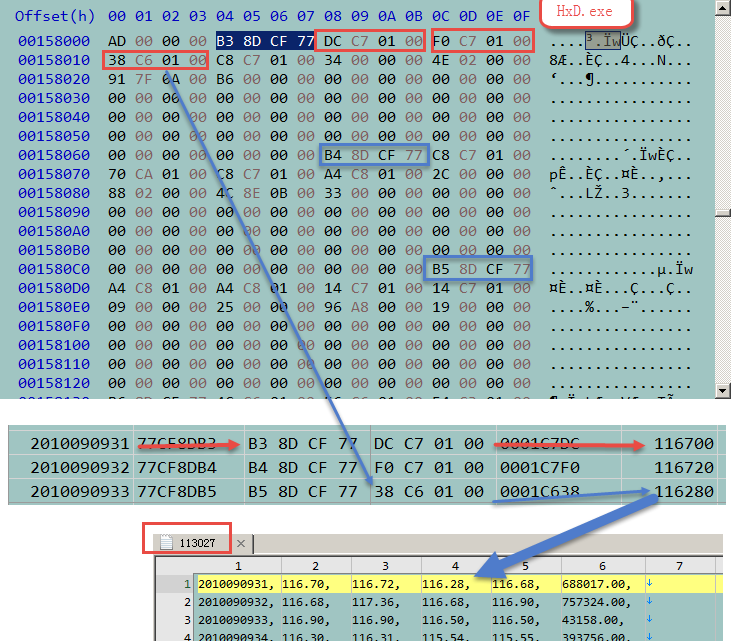

I have found the hexadecimal symbol shown in the first line of the file "113027" in HxD.exe.
The hexadecimal number for data 2010090931 is "B38DCF77" and the hexadecimal number for data 2010090932 is "B48DCF77"

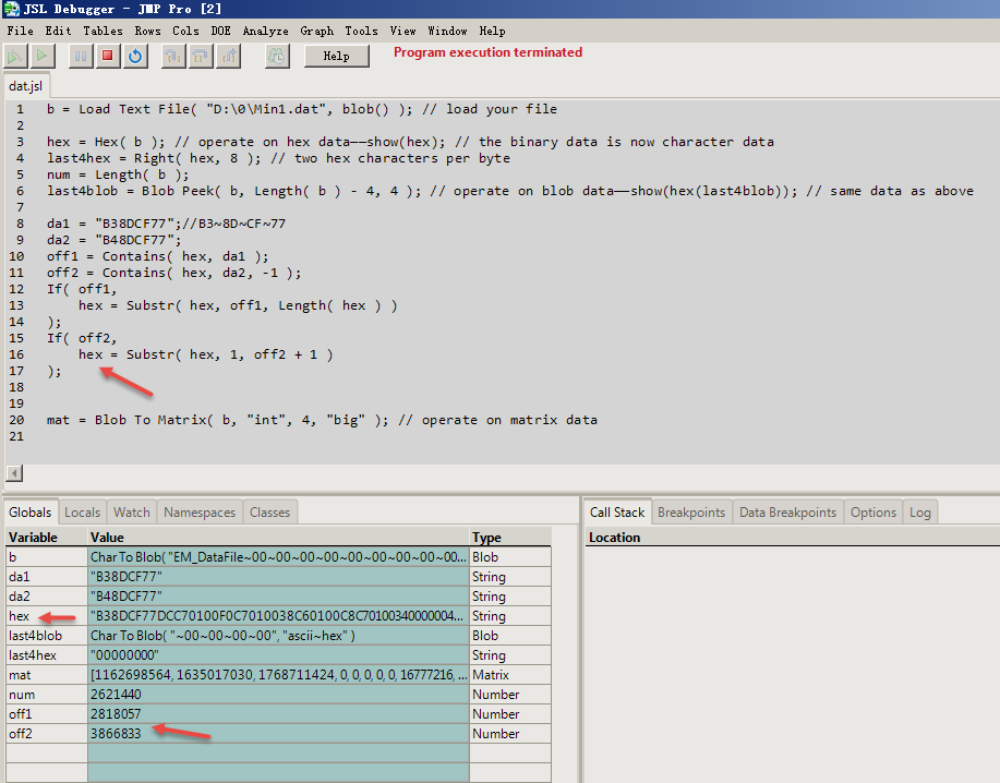

I used "Contains" to determine the location of the time data, but found it inefficient.
hex = Hex( b );
last4hex = Right( hex, 8 );
num = Length( b );
last4blob = Blob Peek( b, Length( b ) - 4, 4 );
da1 = "B38DCF77";//B3~8D~CF~77
da2 = "B48DCF77";
off1 = Contains( hex, da1 );
off2 = Contains( hex, da2, -1 );
If( off1,
	hex = Substr( hex, off1, Length( hex ) )
If( off2,
	hex = Substr( hex, 1, off2 + 1 )
mat = Blob To Matrix( b, "int", 4, "big" );
