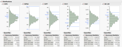

How to exclude rows until distribution mean meets a criteria?
Below is an example similar to my actual case where I would like to exclude SITEs until the distribution mean for each parameter (only those plotted case below) fall within their respective spec limits.
Sites/wafer to be excluded start from the distribution extreme on the side where the mean is outside the spec limit (LSL or USL).
I think one could start with any parameter, remove sites from the distribution extreme until the recalculated mean is >=LSL or <= USL for that parameter, then move to the next parameter and check and exclude sites if necessary.
How to approach this problem with JSL?
Is there a JMP platform which could already do this, e.g. process screening?
The following gives

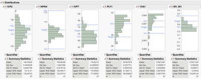

while the desired end result may look something like (filtering done manually, plot below is when done for all wafers).
The act of filtering out SITEs using the recipe above is likely to throw the mean for earlier analysed parameters out of their spec limits. This is what I noticed while doing the exercise manually anyway.  One may need loop the recipe say 5 times over the parameters for a check or until all SITEs have been filtered out. This is what I would like to know from this exercise. I would appreciate some help on how to proceed.
Once checked and done for all parameters, the excluded SITEs need to be tagged as Excluded in a new column (and remaining as Not Excluded).

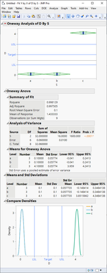

Hi @Neo,
Is your goal to specifically get those means inside the control limits, or are you looking for an automated way to clean up your dataset?  If the latter, you might consider the Explore Outliers platform under the Analyze > Screening menu.  I frequently use the quantile range outliers, and the Robust PCA outliers is very similar to what I typically do inside the PCA platform.
If you are specifically trying to find a set of sites (there are only 5?) or rows that satisfy the condition where they are all within the mean, then I would probably start with a multivariate analysis in order to find rows that have extreme values in multiple columns first.

@ih
Goal is to get the Mean inside Spec Limits for all concerned parameters and not to explore outliers.
Yes, in this example there are 5 sites per lot/wafer (>1000 in my actual case) but I could not find a better example in JMPs sample data.
Had a quick look at Multivariate analysis. I need help with more specifics I should look for under this platform.

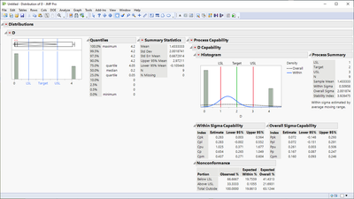

Are you ok with situations like this? Mean is still between the spec limits even though there isn't single result within the spec
-Jarmo

@jthi Thanks for pointing out one of the possible cases which satisfies the requirement but not the objective. I do not understand the Oneway analysis chart but the answer is No for the Distribution chart. In my example, I have got rows within the distribution but you are correct to point out a possibility.
Goal is to bring the Mean of a distribution inside Spec Limits by filtering out (Sites/Wafer in my example case) starting from the extremes of the distribution. While doing this manually, I excluded rows (sites) starting at the distribution extreme on the side where the Mean was outside the spec limit and as mentioned above I had to go back to previously analysed parameters as filtering out sites on subsequent parameters resulted in the mean of previously analysed parameters walking out of the spec limits.

@jthi Thanks. The key bit I was missing in my attempts at a While loop is
	If(N Items(dt << Get Selected Rows) < 1,
		continue_clean = 0;
	dt << Clear Select;
so it was not running as expected.
I have now tested it and modified it to work for several parameter columns following  your script. Still some more testing needed but I think it works as required.
What I need to do next it repeat this analysis for every Wafer. Currently the script runs on all rows in the data table for the chosen parameter column. It is not clear to me on how to limit the analysis to one wafer before proceeding to the next.
End goal is to get the number of excluded rows per wafer (Perhaps adding an new column like ExcludedRows & set =1 in the data table as a part of the analysis could be useful)
But before I request some direction on how to script for repeating the analysis per Wafer
