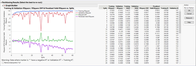

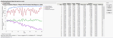

  Back with another JSL programming question. It's related to the other posts through, e.g. here.
  I would like to have a Check Box() functionality that when the check box is checked (state=1), the selected rows (it happens to be rows where RSquare is negative) are selected and then hidden and removed so the updated Graph builder shows the desired output. Then, if the box is unchecked (state=0), in unhides and unexcludes those rows. The Set Function() call I'm using is below, and it works if I run the "script" of the Set Function() manually, but it doesn't do it automatically. I can't figure out what I'm missing in order for it to update automatically. I found a neat post here, and I'm trying to do something like what this person did, but for graph builder update.
JSL Set Function call:
 cb << Set Function(
{this},
this = cb << Get;
If(
this == 1,
dt_results << Select Rows( neg_rows ) << Hide and Exclude;
dt_results << Clear Select;
dt_tb = dt_results << Get As Report();,
this == 0,
dt_results << Select Rows( neg_rows ) << Unhide;
dt_results << Select Rows( neg_rows ) << Unexclude;
);cb << Set Function( {this}, this = cb << Get; If( this == 1, dt_results << Select Rows( neg_rows ) << Hide and Exclude; dt_results << Clear Select;, this == 0, dt_results << Select Rows( neg_rows ) << Unhide; dt_results << Select Rows( neg_rows ) << Unexclude; dt_results << Clear Select; ); );
Where cb is referred to earlier in the code as:
cb = Check Box( "Remove bad points (*'s)?", <<Set( 0 ) )
Starting output, or whenever check box is state = 0.:
Desired output whenever check box is state = 1:
It would be nice to also update the data table as Report on the right so that any of the rows that were excluded were then removed from the Report view on the right, but I think that might be much harder than it sounds. I tried adding an additional Get As Report update in the Set Function() command, but it does nothing.
Any feedback is appreciated, thanks!,

SDF1
Re: JSL Help: Set Function() command syntax help
Hi @ErraticAttack ,
  Thanks for your feedback. I have noticed that this is the second time you've recommended the Namespace() to me ;-).
  As a result, I have spent the past day and a half reading up on using NameSpace in my scripting guide, which is better than the Scripting Index, but still doesn't really give the best examples like how you are using it.  Do you have any primer that is better than the JMP 14 Scripting Guide or Scripting Index on how to use Namespace in the context of how you are using it?
  I have to admit I don't quite follow what you're doing and need to learn it better. However, based on your post here, and on the example code you provided on one of my other posts here,  I was able to re-write my section of script that calls the first window using the Namespace(). But, I'm still not quite sure how I would script-in the subsequent windows and displays that I am able to get to work via my not-so-great scripting skills. I think it's going to take some time to learn how to use Namespace correctly before I can switch over to that programmatic method, which I would like to do.
  I was able to get the graph builder of the display to update upon checking/unchecking the box to hide/exclude the data that is negative (in this case meaningless). The script below does what I want (except for updating the table box when certain data is removed from the graph), but I understand that it's not ideal from the standpoint of programming.
Thanks!,
DS
