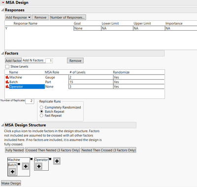

Have you tried looking at the "MSA Design" platform (in "DoE" -> "Special Purpose" -> "MSA Design") ?
Regarding your topic and the nesting between batch and machine, I think the platform may be able to handle your constraint.
Here is an example with factor batch nested within factor machines, and other possible factors :

You can start your design with this platform, and if needed manually add batch replicates or rows on your datatable to account for the difference between batch sizes for the two machines.
