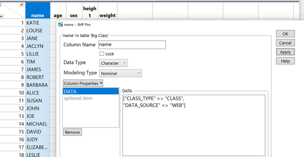

I wonder if there is a good way to add a custom column property that contains double quote and equal sign? The goal is to set the column property shown in the picture with JSL script. For double quote I have tried escape character \!", however; it doesn't work and still shows \!" in the column property.
Thank you,
 Guanxiong
dt:name<<Set Property("DATA", " \!"CLASS_TYPE\!" ")

Are you trying to set Associative Array as column property?

Hi Jarmo:
Thanks for your help; however, for my JMP14, the script still gives "aa" instead of an array in the column property. Do you have any idea or suggestion?

Re: How to add a custom column property that contains double quote and equal sign?
It works! Thanks for your help:)
