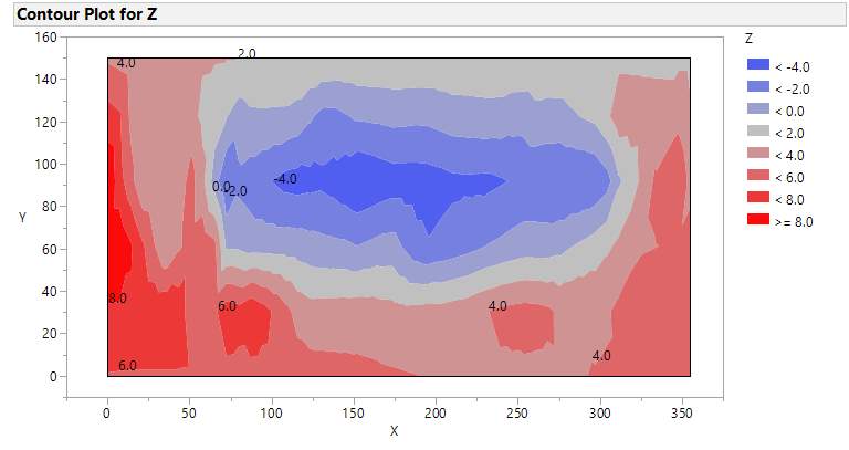

I am trying to create an isopleth of dissolve oxygen for a lake as shown below using JMP. The data I have includes month, depth, and dissolved oxygen.
.Isopleths-of-dissolved-oxygen-for-lake-Rabindra-Sarobar-during-the-simulation-period_W640.jpg

In JMP there are two methods that might work, depending upon your table setup. Likely a contour is what you want
Below is a picture, from JMP sample data Little Pond. Its x axis is spatial distance not time. You will have to customize the color scheme.  A script to create the picture follows.
You can produce a contour with Main Menu Graphs > Contour Plot or Graph Builder. Contour plot has more customization.
From Contour choose Days and Depth for X and Dissolved Oxygen for Y Ask to fill areas.  You can choose your levels for the Z variable (Dissolved Oxygen).

For smoothing, the most general option is to create a smoothed version of your data in a new column with a regular modeling platform or the Guassian Process platform. And then graph that data.
In JMP 14, there is a smoothness slider in Graph Builder's contour element which will dynamically apply a kernel density smoother. However, it doesn't have the line labeling options of the Contour Plot platform.

Oh, one item that is on a wish list that I hope JMP tackles in the next version is to separate the outline of shapes and the fill.
Since I liked your plot with the contour lines visible and a different color than the fill, I decided to see what it would take to get the outlines.  It's not too bad. Here is the picture.  The script is attached; it was tested in JMP12, 13, and 14.
