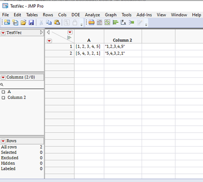

How to create expression columns?
I wanted to play around with expression columns after seeing them in demo videos, but found the info on how to create them actually quite sparse.
I want to create the same sample data set as in Expand Vector Column Addin (TestVec.jmp), by hand (and maybe JSL if nothing else works).
My trouble is that I cannot insert the [] shown - they disappear when typing and JMP adds the quotes "".
Any hints on how to create expression coumns (and especially expression vector columns)?

Re: How to create expression columns?
According to JMP support, this might be a bug in the combination of expression columns, German keyboard and Windows. As workaround, use copy+paste from text editor or something else.
