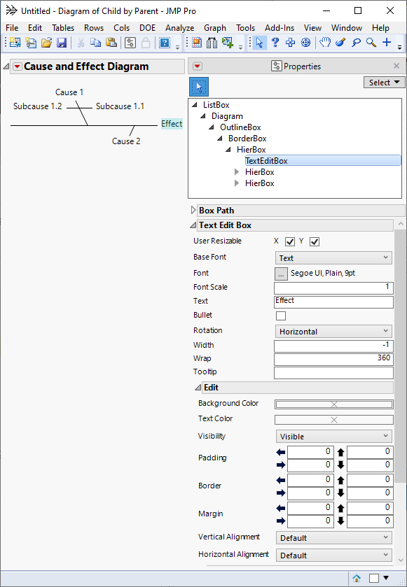

Re: Using JSL (xpath) to change text edit boxes within Cause and Effect Diagrams
You might explore the properties that are available for these text edit boxes. You can quickly, interactively explore them by right-clicking on the reveal button to the left of the outline box:
