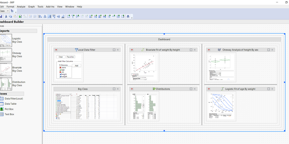

uday_guntupalli
Level VIII
Re: Dashboard window
@Françoise
 While creating the dashboard or with an existing dashboard , if you choose to edit and click on the outer most window, you can adjust its size . Hopefully this helps
Best
Uday

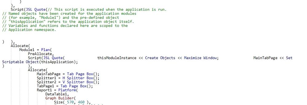

Françoise
Level VI
I don't know where it is inside my script.
Is there at the end of the script: like this?
where is it and wich value?
Best regards

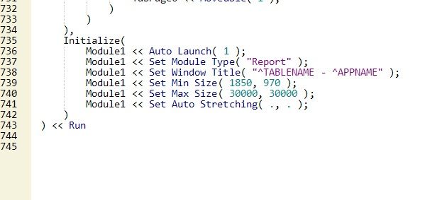

uday_guntupalli
Level VIII
@Françoise
       Can you make this edit on line 739 and see if this edits the window size
Module1 << Set Min Size(2000,1000);
Best
Uday
Françoise
Level VI
Hello,
no change.
best regards
cwillden
Super User (Alumni)
Hi @Françoise,
Put this line in your script just after "thisModuleInstance << Create Objects;"
(thisModuleInstance << Get Box) << Maximize Window;
-- Cameron Willden

cwillden
Super User (Alumni)
You really need to do it on a separate line and make sure you paste it exactly as written. The way you have it right now, you are sending the maximize window message to the module instance, and not the window containing the module instance. The << get box message is critical and so are the parentheses surrounding that code snippet.
-- Cameron Willden
Françoise
Level VI
hello,
I've tried different ways.
no change.
