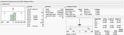

The code is working, only left the part for datatag_cd: parameter for X and Y, I would like to set the limit to +-150. However, the charts generated are all spec limits for Theta only. How do I make the spec limit works?
