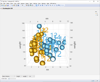

How can display the specified label on a 3D scatter plot?
For example, generate the following 3D graph in Big Class.jmp. How do you make each point display its own age label?
dt << Sort( By( age ), Order( Ascending ), replace table );
ca = "nn";
New Column( ca );
Column( ca ) << Formula(
	If( Row() == 1 | age != Lag( age, 1 ),
		r = Row();
		1;
		Row() - r + 1
dt << run formulas;
Column( ca ) << deleteFormula;
p1 = dt << Scatterplot 3D(
	Y( :height, :weight, :nn ),
	Weight( :age ),
	Coloring( :sex ),
	Sized Points( 1 ),
	Legend( 9 ),
	Frame3D(
		Set Graph Size( 1066, 741 ),
		Legend( 1 ),
		Set Grab Handles( 0 ),
		Set Rotation( 5.79529088089731, 66.3611426483183, -5.39187559662059 ),
		Set Marker Quality( 1 )
Thanks!

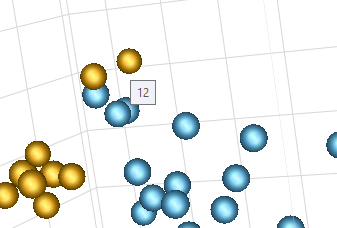

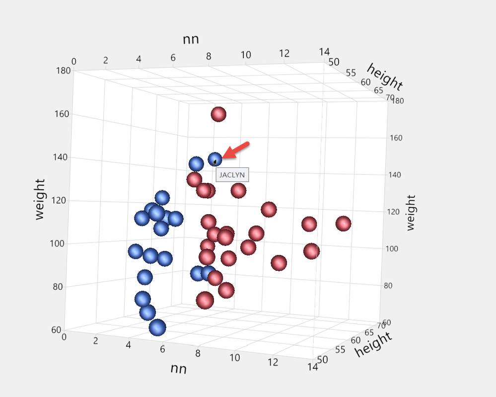

Remove Label column property from name, add label property to age, add label row state to all rows and select those rows
you could also select something from 3d scatterplot to make them appear
If you just want to see those on hover over, skip row states
-Jarmo

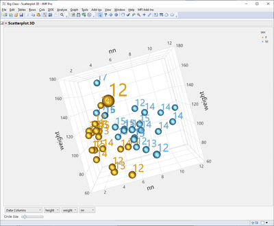

How to adjust the circle size in 3D Scatterplot using JSL?There is no recording in the recorded source code.
Thanks!
jthi
Re: How can display the specified label on a 3D scatter plot?
If nothing else, you can get the reference to the slider box and use <<Set
Names Default To Here(1);
dt = Open("$SAMPLE_DATA/Iris.jmp");
obj = dt << Scatterplot 3D(
	Y(:Sepal length, :Sepal width, :Petal length, :Petal width)
wait(1);
Report(obj)[SliderBox(1)] << Set(0.01);
but there is also Frame3D(Set Marker Scale)
obj = Scatterplot 3D(
wait(1); obj << Frame3D(Set Marker Scale(10));
-Jarmo
