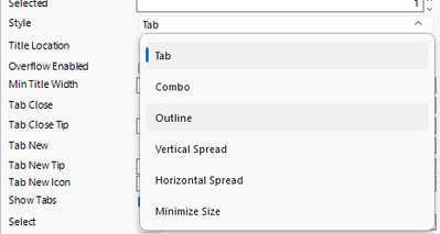

Re: How to create a interactive HTML with two tabs which change the chart image in one based on the value choosen in dropdown list
To get a Dropdown menu instead of Tabs, you can change the "Style" to "Combo":
edit:
but the exported HTML file doesn't use this setting - it will use Tab mode again:
