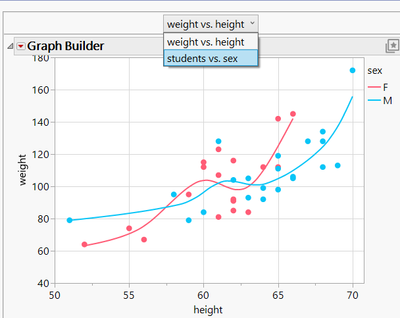

To get a Dropdown menu instead of Tabs, you can change the "Style" to "Combo":

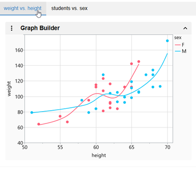

edit:
but the exported HTML file doesn't use this setting - it will use Tab mode again:
