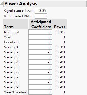

I don't know the standard deviation of your response or the minimum effect that you are trying to detect but this comparison is fair because I use 1 for the standard deviation (Anticipated RMSE) and 1 for the parameter value (with coding of factor levels, the value is equivalent to an effect that is twice the standard deviation) in both analyses. Here is the power analysis using the random block effect in the model:
(RCBD with random block effects in the model)

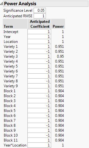

Here is the power analysis using your model:
(RCBD with fixed block effects in the model)
So you can see that the power is essentially the same for the effects of interest. Your choice should come down to how you think about the block effect. A random effect seems appropriate to me. Why would you want to model Block as a fixed effect? I do not mean that question as a challenge. It is simply something to think about.

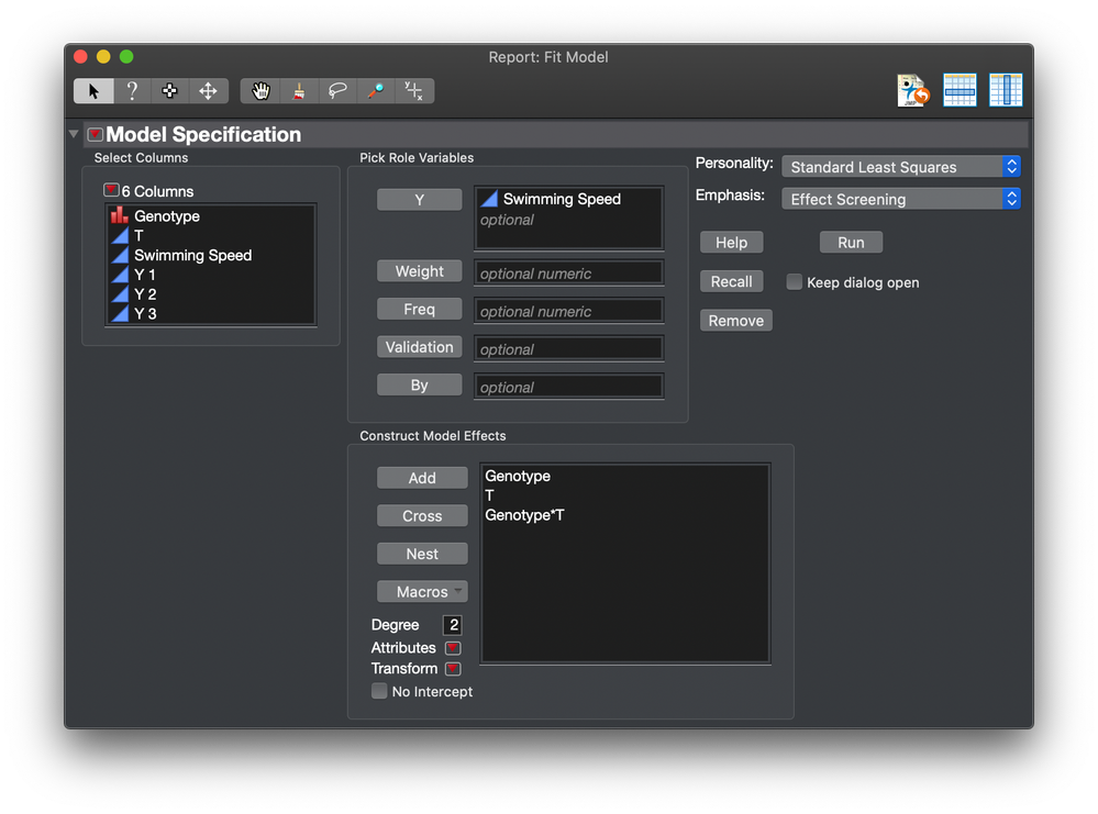

Thank you for this discussion of RCBD design 3 years ago. I followed this discussion, but I am still uncertain how to specify my model, which is actually much more simple. It also includes an effect nested within a combination of two other effects. Specifically, I have 4 genotypes reared at 2 temperatures and 4-5 individuals per combination of temperature and phenotype measured repeatedly (many observations of swimming speed per individual). So individuals are random effect nested within genotypeXtemperature. When I do as you suggested in the discussion above to specify individual with unique IDs and run this:
Fit ModelY( :)Effects( :Genotype, :T, :T * :Genotype, :G_T_Ind & Random)
I get lost DF's and nothing is evaluated.
There must be a way to specify that individuals are unique within a combination of :T * :Genotype, right?
Thanks in advance!
L.Yampolsky
Re: How to create a Nested effect within interaction factors?
Here is a simple example to illustrate how I interpret your design.
You included 4 x 2 = 8 treatments. Each treatment was replicated with multiple subjects (e.g., 5 times). Each subject was observed multiple times (e.g., 3 times). Is that essentially what you did?
So you could use the average of the observations as the response from each individual. This way, the residual error is individual and you do not need a term in the model. (You could also create and model the variance of the observations to see if the treatment affected the variability, too.)
Alternatively, you could use the individual observations. You must stack the separate observation columns first and create a new column for the identity of the individual. The ID column would be added as the random effect.
The new table looks like this:
So the model changes to this:
This way, the individual contributes a random effect but it is not a nested effect. It acts like a random block.
