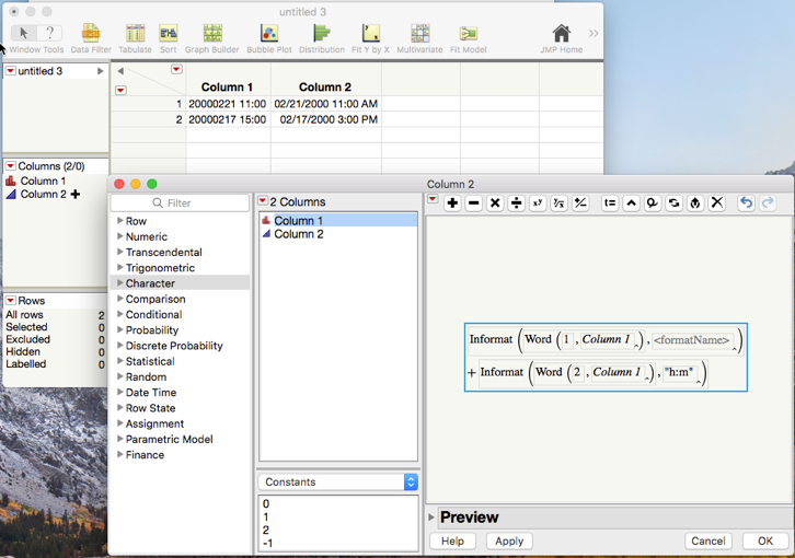

Hello, everyone!
How to use JSL or formula to convert the text of column 1 into the time format of column 2.
Thanks!

Here is the formula for the conversion
Date DMY(
	Num( Substr( :date, 7, 2 ) ),
	Num( Substr( :date, 5, 2 ) ),
	Num( Substr( :date, 1, 4 ) ) ) +
	60 * 60 * Num( Word( 2, :date, " :" ) ) +
	60 * Num( Word( -1, :date, " :" ) )
Jim
Jeff_Perkinson
Re: How to convert text format Numbers to yyyymmdd hh:mm format?
@txnelson's formula will work but there's a slightly simpler formula that will work also.
This one uses Informat() to convert the date and time values.
Informat( Word( 1, :Column 1 ) ) +Informat( Word( 2, :Column 1 ), "h:m" )
-Jeff

The column names in the diagram should be
yyyymmdd hh:mm

lwx228
Level VIII
Thanks!
Jim Let me know the principle, Jeff_Perkinson let me learn JMP function.
