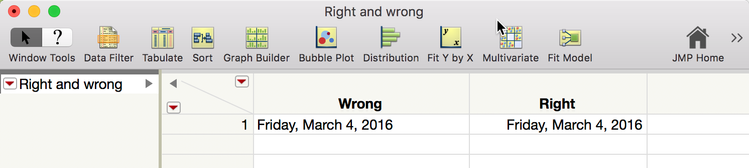

When importing data, it is important to ensure that your time-based values are stored as the numeric values described above. Most of the time, JMP will do this automatically as it tries to recognize time-based values during import or copy/paste operations. You can tell if this has been done correctly by looking at which way the values in the column are justified in the data table. Numeric values are right-justified, and character values are left-justfied.
Wrong is a character column. Notice it is left-justified. Right is numeric column. It is right-justified.Wrong is a character column. Notice it is left-justified. Right is numeric column. It is right-justified.

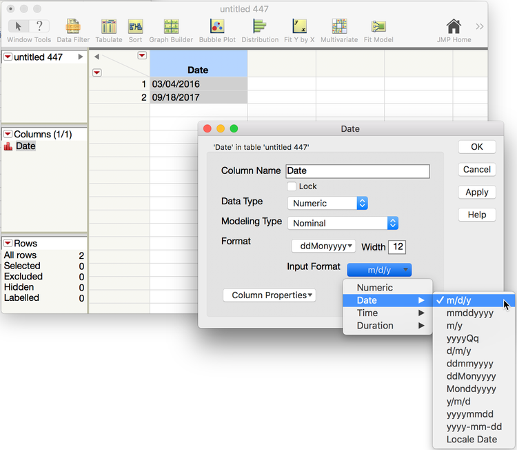

If you find that you have time-based values that are stored as character strings, you can convert them using the Column Info dialog box. Just change the Data Type to numeric, the Format to your desired date/time format, and the Input Format to the one that describes the character strings that are in your data. JMP will then convert the values to the appropriate numeric values.
First change the Data Type to Numeric.First change the Data Type to Numeric.
Pick the Format that you want to use to display the time-based value.Pick the Format that you want to use to display the time-based value.
Finally, change the Input format to match the format of the strings in the column.Finally, change the Input format to match the format of the strings in the column.
