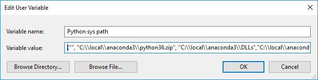

Of course, after I post I find a better way, but it involves setting an environment variable.  JMP 14 is looking for an environment variable.  It is the sys.path that I described in the previous post, however you need to set to be a JSL List of paths.  On Windows 10, you need to go to system properties, Advanced System Settings, Environment Variables and create a new Environment Variable.
Variable Name:    Python sys path
Variable Value:    {"", "C:\\local\\anaconda3\\python36.zip", "C:\\local\\anaconda3\\DLLs",
"C:\\local\\anaconda3\\lib", "C:\\local\\anaconda3", "C:\\local\\anaconda3\\lib\\site-packages",
"C:\\local\\anaconda3\\lib\\site-packages\\win32",
"C:\\local\\anaconda3\\lib\\site-packages\\win32\\lib",
"C:\\local\\anaconda3\\lib\\site-packages\\Pythonwin"}
Which then allows this script

Thanks for your work, unfortunately I just have JMP version 13.0. And I work with Python version 3.7.1 without Anaconda.
I have all the libraries needed ( numpy, scipy, matplotlib, panda... ).
I am on windows 10, I did your "variable name" trick (that is well explained by the way) but with this piece of code I'm struggling...
Have a look at it instead :

Hi Paul,
I am just trying to send a datatable to Python. However, all columns end up in one string column with the actual columns separated by \t (see picture). Any idea what goes wrong here? Do you need a special pandas version (or a special matplotlib version, as this also causes an error)?
Regarding the configuration of Python it would be great if one could select a conda environment which should be used.
Regards
Gerd
Re: How to configure Python for JMP 14?
You need to set your Python Init(), and/or  your system environment variables, to point ot the conda installation.  See the earlier responses to this community posting. There are examples of both setting the parameters withing the Python Init(), and setting environment variables to point to you python installation.
