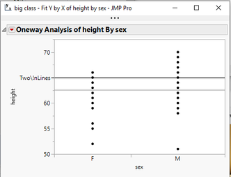

Is there any way to have a two-line label for a reference line? My lable has to be long and it eats up a lot of valuable screen space. Would be ideal if I could break it into two lines. Any way to achieve that?
txnelson
Re: Multiline label for reference line?
I don't believe there is a direct way to do it.  I was hoping that by embedding \!n, the standard new line sequence that it would break the line, but it does not recognize it

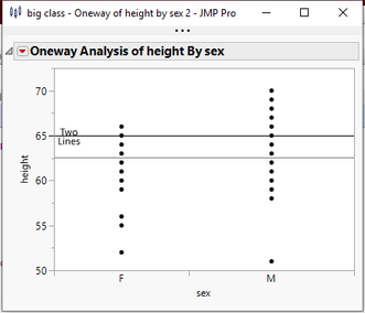

You could draw the reference line without any label, and then use the << Add Graphics Script  to add the info
names default to here(1);
dt = open("$SAMPLE_DATA/big class.jmp");
ow = Oneway(
	Y( :height ),
	X( :sex ),
	SendToReport(
		Dispatch( {}, "1", ScaleBox, {Add Ref Line( 65, "Solid", "Black", "", 1 )} )
report(ow)[framebox(1)] << add graphics script(
	Text( Center Justified, {2, 65}, "Two" );
				Text( Center Justified, {2, 64}, "Lines" );

Yeah, looks like this is the easiest workaround. Thanks!
