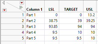

This is an example of what I have.

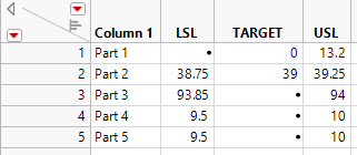

This is what I would like to have
