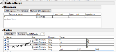

I am working in formulation team and a very new to DoE. Need guidance for a DoE with below conditions:
there are 5 factors : P1 (%), P2 (%), P3 (%), P4 (%) and P5 (ppm)
P4 is used for volume make up & the equation is P4 = 100 - (P1+P2+P3)
P4 also has effect on Y (response).
P1, P2 and P3 have 2 level discrete values while P5 has 3 level discrete value.
Please see the image for reference:
My queries:
1. how to include P4 and keep the total (P1+P2+P3+P4)=100
2. Previously we tried to do DoE with only P1, P2, P3 and P5 and after designing, added P4 manually to resultant DoE table (i.e. P4= 100-(P1+P2+P3)) - is it recommended?
Much Thanks-
Simanti

Thank you for your response.
