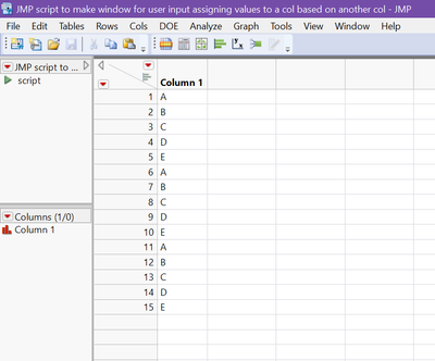

I have a dataset that looks like this, but with a lot more categories, each with longer names.
I want to create another column, with numeric values, based on the given column. This product needs to be fully automated, with a pop-up window with each of the categories listed out, with number edit boxes that the user can input the numeric values that will correspond to a category. For example:

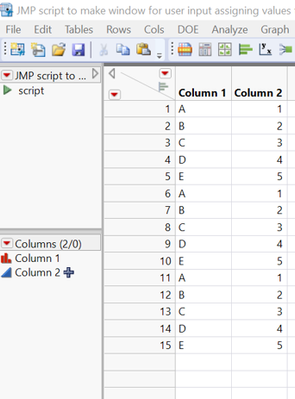

The resulting data table should look like this:

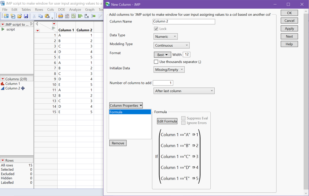

The results from this will be the automated and user-friendly version of using the following conditional logic to make column 2 based on column 1's categories.
