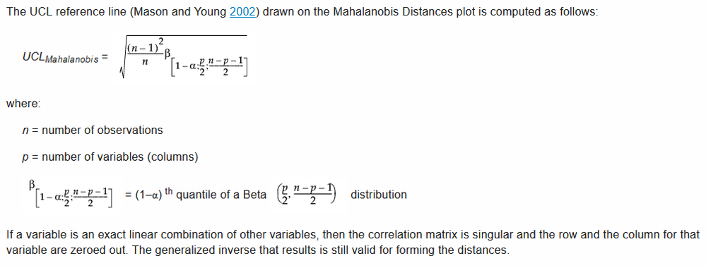

Click the "?" from JMP toolbar and then click on Mahalanobis Distances, this will open Help page Outlier Analysis . From here you can find Mahalanobis Distance and find its documentation Mahalanobis Distance Measures and finally

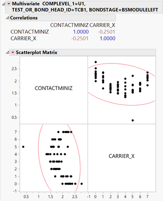

I try to follow your instruction but the result is not correct.
I will display the script below and image

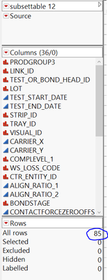

Based on your instruction, does p =2 and n = 85
Multivariate(
	Y(:DELTAMINIZ, :CARRIER_X),
	Estimation Method("Row-wise"),
	Matrix Format("Square"),
	Scatterplot Matrix(Density Ellipses(1), Shaded Ellipses(0), Ellipse Color(3)),
	Jackknife Distances(1)
Re: How to calculate UCL from Mahalanobis Distance
What is the UCL shown if you click the red triangle next to Multivariate and select Outlier Analysis > Mahalanobis Distance?

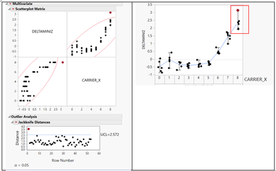

I use Jackknife method to detect outlier, but I found 1 case that I really need your advice.
You can refer to the images below.
Based on the right chart, all the data points on 8th carrier_x should be outliers. However, when I use Jackknife method with default settings, this method only points out 1 outlier instead 4.
I believe that not enough data points leads to the result
Do you have any suggestion / method that I can catch outliers more efficiently?
