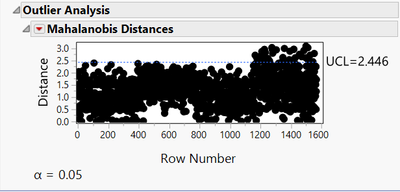

Hi all,
Currently, I am using JMP 12 version
Do you know how to calculate UCL distance from Mahalanobis Distance chart?
If you guy know how to get it, could you please show me the formula?
Sincerely

I believe you are misusing the outlier analysis. It applies to linear correlations. You have a non-linear relationship between two variables. I would not expect it to correctly identify outliers and non-outliers in such a case.

Appreciate for your input. You are correct. Both variables are non-linear. Which method can I use to detect outliers from non-linear variables.
