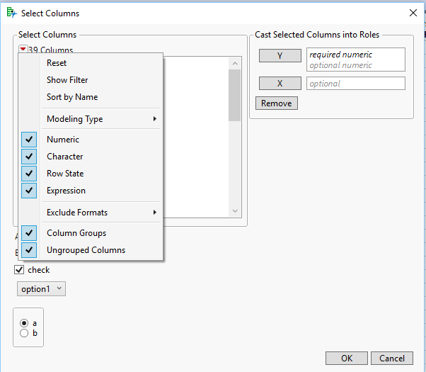

txnelson
Re: How to add a Filter column button in a column dialog box.
The Column Dialog() object automatically creates a column list with a filter.  Below is the example taken directly from the Scripting Index

Rajat
Level IV
If I run the code mentioned in the problem, it only shows the list of columns and variables that I have to select. Can it be like, it shows a search button, where I can type required column name and it will filter out the column list containing that name.

Rajat
Level IV
Thanks txnelson filter option shows in JMP14. Appreciate your help.
Do you know any command so, filter option get showed automatically in the column dialog.
