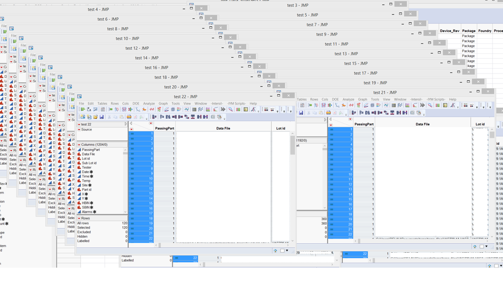

this is what I end up when the final report/jrn is completed!
