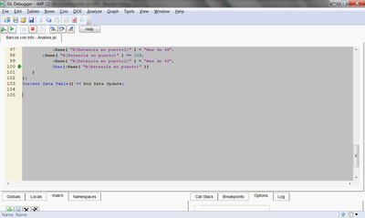

Hi folks,
I am trying to use JSL Debugger for first time and I could not control how to display botton page tabs, as Global, Local, Watch, ...
I do not know why, but in my window I see the one I leave here so I can't see Variable values
(even I do CRTL-SHIF- - to decrease view).
Could you help me?w.  Thank you
Teresa

Re: How may I see variable tabs in JSL Debugger
OK, I just randomly tried this and it worked on Windows 7 Professional 64 bit, JMP 10.0.2 64-bit edition:
Hover your mouse around the bottom of the frame where you have your script on a gray background, hover until you find the location where your mouse pointer turns into a double sided arrow (as if it will let you change the size of that frame/screen). Right click at that location and you will see a dotted line around the gray area, then left click to resize it. It worked for me, now I can see the globals at the bottom. I am not sure if this is the intended way it should work, it is really finicky, it might be a bug...
