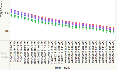

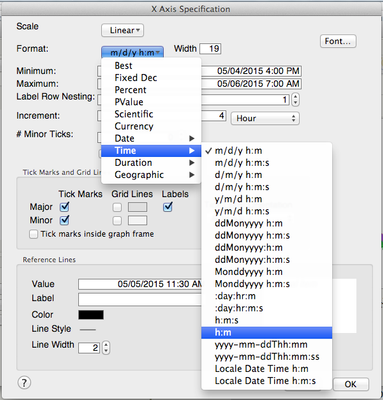

What I have done way to keep units fixed, is changing the Column type to "Numeric, Nominal". Then change the Format to something simple, like hours.
This has worked for me. It keeps the ticks fixed.
