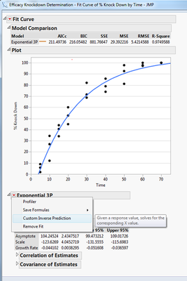

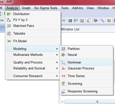

Re: interpolate x values from a standard curve
Use the "nonlinear" platform under "analyze" and "modeling".
After fitting curves, you can use the "Custom Inverse Prediction" for interpolating "x" values.

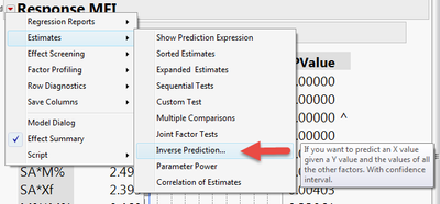

Hello,
Inverse prediction is available is several platforms including fit model.
