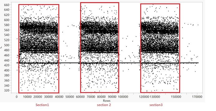

How do we filter data based on time and take the average using JSL?
I have data captured for a particular duration of time. Please find below snapshot of the table (attached the same):
TimeStampABC
0.00110.005450.4451428.9093
0.00210.01450.8904429.0295
0.00310.015451.336429.0177
0.00410.02451.7818428.9279
0.00510.025452.2278428.8491
The plot of column C looks like below:
I need to filter the rows in section1 , 2 & 3 and find their average.
Each section spans for 30second duration which is calculated from timestamp column  and there is a 20 second interval between each section.
The final result table should be as below:
Sectionmean(A)mean(B)mean(C)
Could you please advise how can we filter the rows in section1 , 2 & 3 and find their average using script.
txnelson
Re: How do we filter data based on time and take the average using JSL?
Here is how I would do it.  It does not match your results, but it does follow the directions you indicated, calculating the Section based upon the TimeStamp values of 0-30 = Section 1, 50-80 = Section 2, 100-130 = Section 3
names default to here(1);
dt=current data table();
dt << new column("Section",
	ordinal,
	formula(
		If( 0 <= :TimeStamp <= 30,
			1,
			50 <= :TimeStamp <= 80,
			2,
			100 <= :TimeStamp <= 130,
			3
dt << Summary(
	Group( :Section ),
	Mean( :A ),
	Mean( :B ),
	Mean( :C ),
	Freq( "None" ),
	Weight( "None" ),
	Link to original data table( 0 )
Jim

jojmp
Level III
Is it possible to give some meaningful names to each section instead of 1, 2 and 3. For example can we name it as interval_1, interval_2 etc.
I tried this but the code doesn't run when I try it
txnelson
In the example I provided, the Section column was created as a Numeric column.  The values for numeric columns have to be valid numbers.  However, it is a simple matter to make the column a Character column and then the values of Section can be anything you want.
	ordinal,character,
	formula(
			"Interval_1",
			"Interval_2",
			"Interval_3"
I strongly suggest that you take the time to read the Discovering JMP and Using JMP documents from the JMP Documentation Library available under the Help pull down menu
Jim
