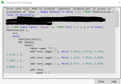

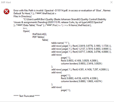

Sorry, I have to return with yet more questions because somehow, despite years of academic training, I cannot get this loop to function. Here's what I tried to make it work: First I moved all files to my local hard disk, because for some reason we are using "()" in some of our folder names on the server and I had the impression this was creating an issue. Eventually, I "quoted" the whole directory in the script using  quotation marks, which seemed to convince the script to run until the next error message. Then it told me something about "Path is invalid ...'Glue' ...". I googled it, but have no idea how to address that issue. I can see that the file name in the error message is the name of one of the files in the directory I want to work with. First I thought the hyphen in the file name was creating an issue, but even when changing that the error occurs.
I have pasted in below:
  • A copy of the script with a fake directory name. I preserved the number of folders as well as the folder name containing parentheses.
  • The error message from the script window
  • The error message from debugging
Also, how do I include the directory AND filename in the final data table?
Thank you very much in advance! (If you find this too trivial to answer, I will understand.)

txnelson
Re: How to import multiple pdf files into data table
My error........
Data table( "Final" );
should have been specified
New Table( "Final" );
