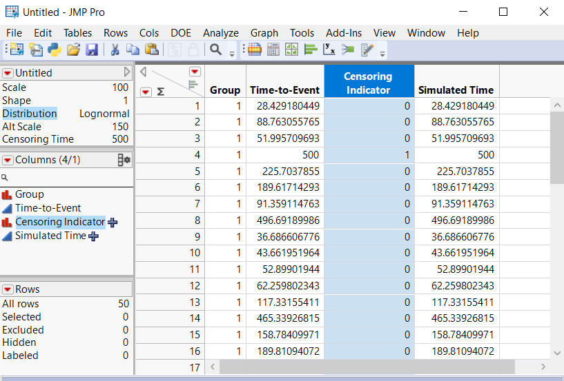

One workaround you could do (assuming you have JMP Pro) is to utilize the one-click simulate feature that is available in many platforms. Start by creating a data table with a Group column, a Time-to-Event column, a Censoring column, and then a column to simulate times-to-event. Here's an example of what that might look like:
For the Time-to-Event column, I simply pasted in the values from the Simulated Time column. The table variables are referenced in the simulation column (don't worry; I'll share this table in my response so you can play with it).

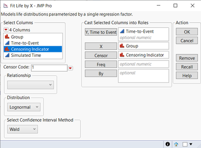

Next, we can run Fit Life by X under the Analyze>>Reliability and Survival menu. Fill it out like so:

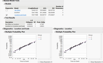

Click Run and then scroll down until you see a table labeled Test Results:

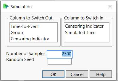

Right-click in the column labeled Prob>ChiSq and select Simulate (it's near the bottom of the pop-up menu). You'll see a window like this:
Select Time-to-Event to Switch Out and Simulated Time to Switch In. Make sure the Censoring Indicator column is referencing the simulation column, otherwise it won't be correct for the simulated times generated from this.

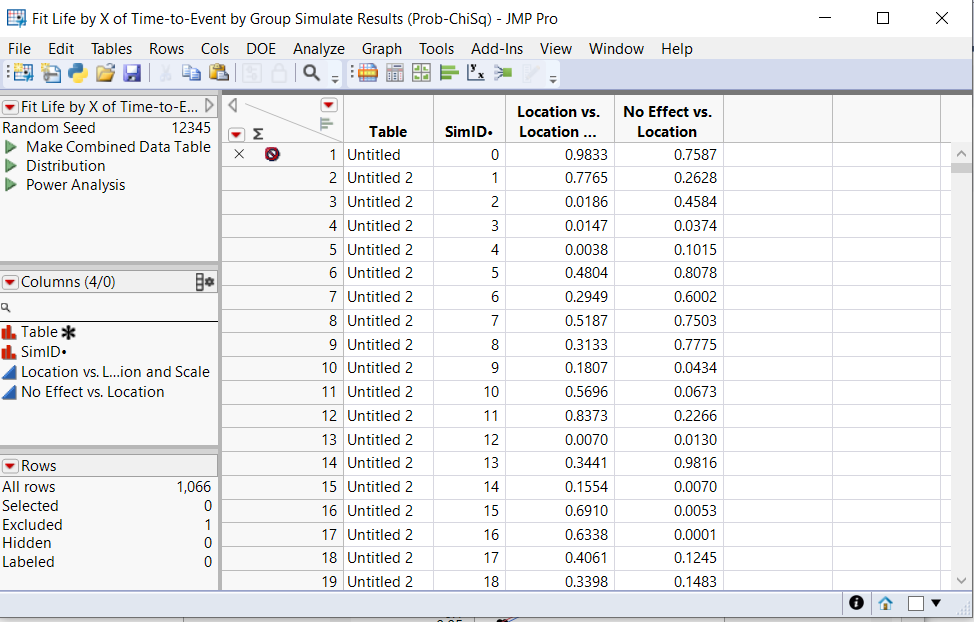

Set the number of samples to any number you like as well as the random see if you want (I used 12345), then click OK. Once the simulations have finished, you'll have a data table that looks like this:

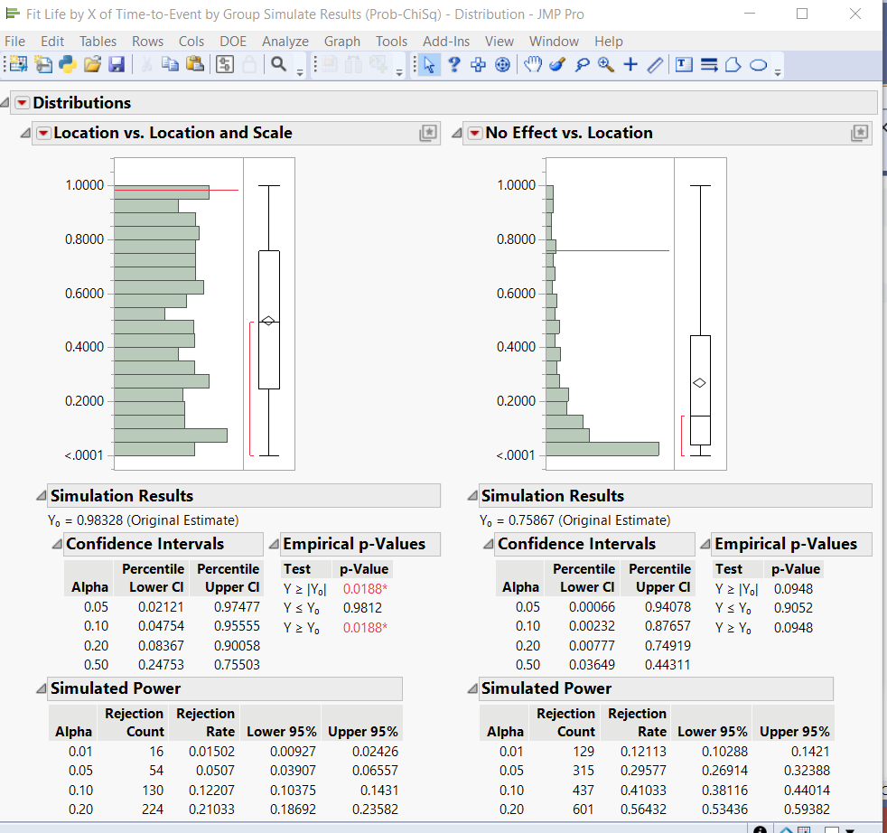

I decided to stop mine early (around 1000 runs) just for the sake of time. One of the table scripts is labeled Power Analysis. If you run the one-click simulate off of a column with p-values, JMP automatically assumes you're probably doing a custom power analysis. If you run that script, it will open a special instance of the Distribution platform:
In this case, for an alpha of 0.05, we have a power of around 30% (%29.577 to be exact) to detect the difference I indicated in the table (100 time units vs. 150). At this point, I can go back to the table, add some more rows for each group (easiest might be to scroll to the last row of that group, right-click, select Add Rows, add the desired number of rows, and then fill in with the group number), and then repeat the whole process.

Thank you for your response :) i think this will hep alot. i have one uncertainty about this part of your explanation, ''Make sure the Censoring Indicator column is referencing the simulation column, otherwise it won't be correct for the simulated times generated from this.'' how should i make sure about that? :)
