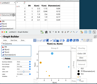

Re: Making Graph Builder's "Size" scale to axes
easy solution, but not perfectly scaled
Solving the problem with just a little clicking around:
In graph builder I put X and Y on the X and Y axis boxes, then drug SN to the color role and Diameter to the size role.
Here's what the script would look like:
Graph Builder(
	Size( 409, 391 ),
	Variables(
		X( :"X(cm)"n ),
		Y( :"Y(cm)"n ),
		Color( :SN ),
		Size( :"Diameter(cm)"n )
	Elements( Points( X, Y, Legend( 9 ) ) )
JMP Systems Engineer, Health and Life Sciences (Pharma)

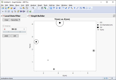

I think you might have to do this with a graphic script. Below is very quick and hacky solution, it can give an idea what you could possibly do
Names Default To Here(1);
dt = New Table("Untitled",
	Add Rows(5),
	Compress File When Saved(1),
	New Column("SN", Numeric, "Continuous", Format("Best", 12), Set Values([1, 1, 1, 2, 2])),
	New Column("X(cm)", Numeric, "Continuous", Set Values([2.2999999999999998, 2.7000000000000002, 1.5, 5.4000000000000004, 3.1000000000000001])),
	New Column("Y(cm)", Numeric, "Continuous", Set Values([1.1499999999999999, 0.44, 2.6000000000000001, 1.8999999999999999, 4.0999999999999996])),
	New Column("Diameter(cm)",
		Numeric,
		"Continuous",
		Set Values([0.040000000000000001, 0.12, 0.34999999999999998, 0.17000000000000001, 0.58999999999999997])
gb = dt << Graph Builder(
	Size(518, 454),
	Show Control Panel(0),
	Lock Scales(1),
	Variables(X(:"X(cm)"n), Y(:"Y(cm)"n), Size(:"Diameter(cm)"n)),
	Elements(Points(X, Y, Legend(5))),
	Local Data Filter(Add Filter(columns(:SN), Modeling Type(:SN, Nominal)))
frame = Report(gb)[FrameBox(1)];
Eval(EvalExpr(
	frame << Add Graphics Script(
		cur_gb = Expr(Report(gb));
		fb = cur_gb[FrameBox(1)];
		ms = fb << Find Seg(Marker Seg(1));
		xs = ms << Get X Values;
		ys = ms << Get Y Values;
		For(i = 1, i <= N Items(xs), i++,
			dt = cur_gb << Get Data Table;
			m_rows = dt << Get Rows Where(:"X(cm)"n == xs[i] & :"Y(cm)"n);
			diam = dt[m_rows, "Diameter(cm)"][1];
			Circle({xs[i], ys[i]}, diam/2);
Also read how Circle's radius behaves https://www.jmp.com/support/help/en/18.0/#page/jmp/graphics-functions.shtml?os=win&source=applicatio...
-Jarmo

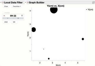

jthi
Of course. You could modify it a bit to use "FILL" argument in Circle so it would look something like this (might be a good idea to hide legend when you do this as the circles contain the size information not the underlaying markers)
-Jarmo

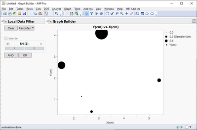

I'm not quite following this entire discussion, but I thought a few notes might be relevant.
  • There is a "Size to Isometric" command in Right Click > Graph > Size/Scale > Size To Isometric. It sizes the graph so that the X and Y have the same values per pixel. It doesn't persist though.
  • The size variable is represented as circle area, not diameter.
  • A few versions ago we added the Marker Draw Expo functionality to markers and Graph Builder (called Shape Expressions under Points red-triangle menu).
Graph Builder(
	Size( 496, 501 ),
	Show Control Panel( 0 ),
	Lock Scales(1),
	Variables( X( :"X(cm)"n ), Y( :"Y(cm)"n ) ),
	Elements(
		Points( X, Y, Legend( 5 ),
			Set Shape Expression(
				Expr(
					Function( {this seg, this row, x, y, pixel size, row state},
						{r = :"Diameter(cm)"n / 2},
						Oval( x - r, y + r, x + r, y - r, 1 )
	Local Data Filter( Add Filter( columns( :SN ), Modeling Type( :SN, Nominal ) ) ),
	SendToReport(
		Dispatch( {}, "Graph Builder", FrameBox, {Size To Isometric} )
