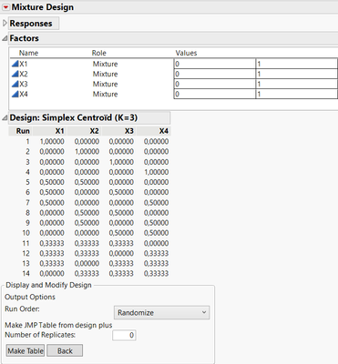

  • Without factors ranges restrictions and linear constraints: choosing a Simplex Centroïd design with K=3 generates a design with up to 3 factors in each experiment :

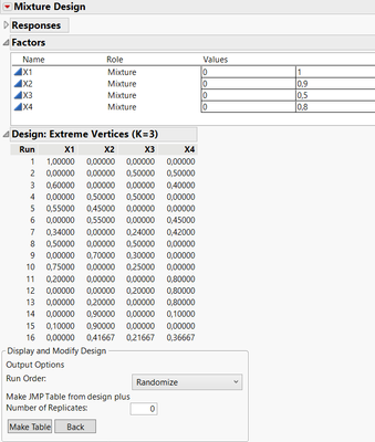

  • With factors ranges restrictions and/or linear constraints: choosing an Extreme Vertices design of degree K=3 generates a design with up to 3 factors in each experiment :
