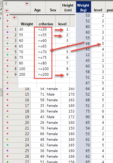

lwx228
Level VIII
Re: How do I use JSL to categorize positive and negative values in the same column?
See screenshot for standard: The operation of this step, I can only use the way of "IF". Excel has several functions that do this. How does JSL do this quickly?Thank you very much!
txnelson
This can be handled easily in a JMP formula
If(weight<=30, 1
weight <= 40, 2,
weight <= 50, 3,
etc.
Jim
lwx228
Level VIII
Thank Jim!
but If this grade classification reaches more than 100, such classification method code is more cumbersome.
If you had the classification in a table as shown above, a script could easily create the expression for the necessary If() function. Or you could use the approach of lookup in such a table.
More than 100 classes? Would they be meaningful or useful? At this point you might want to just use the original continuous variable.
