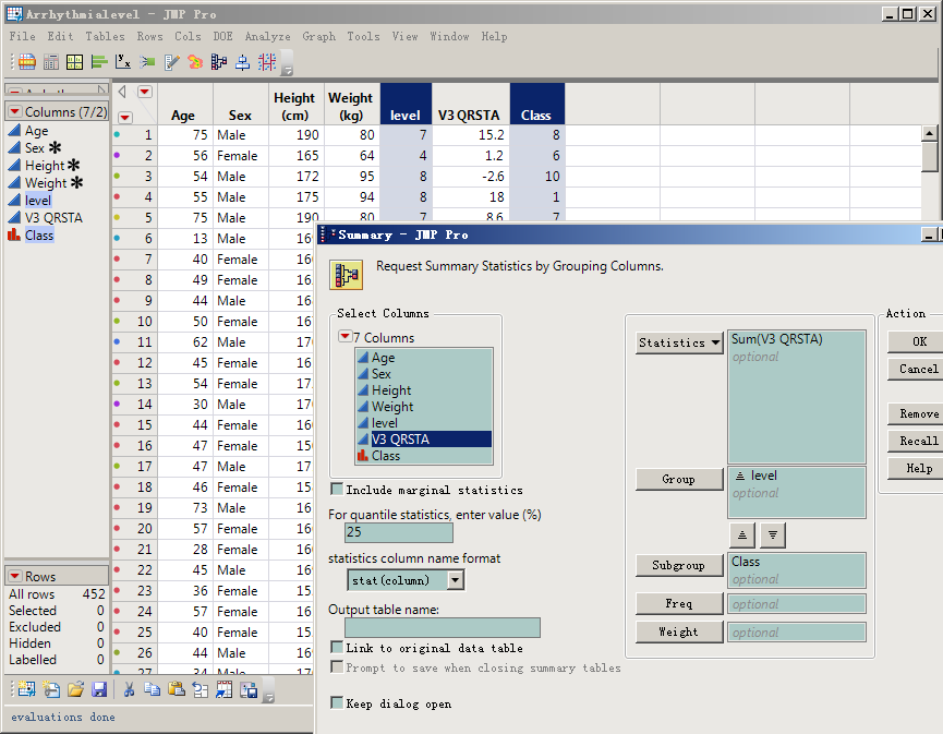

lwx228
Level VIII
Re: How do I use JSL to categorize positive and negative values in the same column?
Now I want to summarize the positive value and negative value of column "V3 QRSTA" respectively by adding the weight "level" column and "class" column.
How to do this with JSL?
I have uploaded the data related to calculation in the attachment.Thanks!
