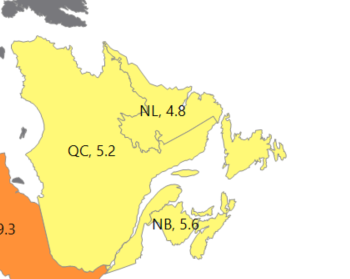

Hello. I am trying to get the labels in this map to be 'stacked' (so that it says the abbreviation on one line and then the number on the next line). Is there a way to do this? Thank you!

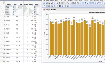

I think one fairly easy option which should work is to create new column with ",\!N" as separator between different values.
Names Default To Here(1);
:name << Label(0);
new_col = dt << New Column("LABEL", Character, Nominal, Formula(
	Char(:height) ||",\!N" || Char(:weight)
new_col << Label(1);
gb = dt << Graph Builder(
	Size(1029, 499),
	Variables(X(:name), Y(:height)),
	Elements(Bar(X, Y, Legend(6), Label("Label by Row")))
-Jarmo

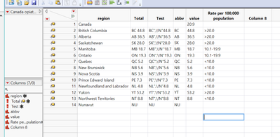

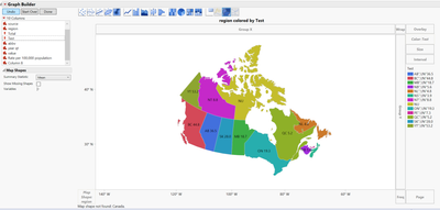

patriciafm811
Level III
Re: How do I get labels to 'stack' in graph builder?
So I tried this and I can't get it to work in the map.

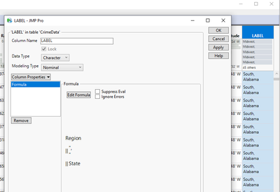

jthi
You have to use label only on the formula column. And I'm not sure if you can write row change to the column by hand (that is why I did use formula with concatenation). You can see that the "\!N" is not visible in my rows
