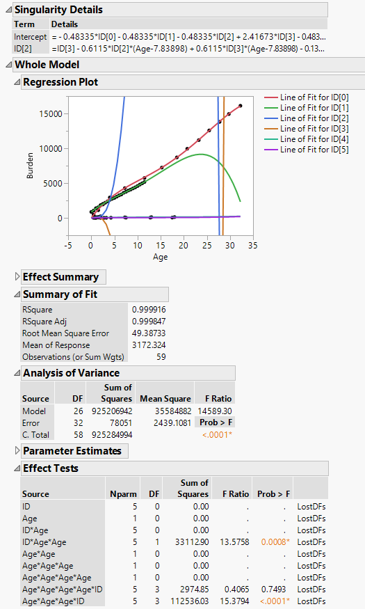

As long as I can state with 95% confidence using ANCOVA that my slopes are statistically different due to location or in this case ID I am very happy with the original model. I have included the age*age, age*age*age, and age*age*age*age just to be sure.ANCOVAOutput5.PNG

The new analysis with the higher orders should include ID alone and crossed with each of the Age terms. (Sorry I did not make that point clear before now.)

I included ID in this last model and received the error "Warning: Ill-conditioned regression problem" and the following output. ANCOVAOutput6.PNG

I think that result is because not all of the ID levels have enough data to fit all the higher order terms.

There are very few points for 2 of the individuals. If there is an alternative test please let me know. Thanks for all of your help!

Right. I think that the best you can do is to use the reduced model (Age, ID, Age*ID) and the tests that the provide. (We already covered that option.)
