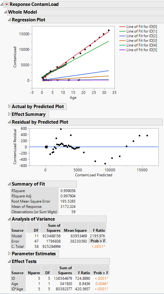

Re: How do I determine statistical difference in slopes with non-normal data
Mark Bailey,
Thank you for the quick response and for clarifying the observed Y or X do not have to be normal. I have included the output using your suggestions and found that the Individual*age is significant. I have included the model output below. To clarify, the residuals by predicted plot show a u-shaped and inverted-u shaped curve and visually there is no random pattern. Is this acceptable for this model?
Again, thank you for the response. I look forward to your reply.
Glad you picked up on the residual analysis. It is easy to do but many people don't look at it. You have bias in the current model. There are non-linear changes in the response. Maybe not for everyone. But add Age*Age (i.e. X squared) and Age* Age * Individual  (curvature not the same for each subject) to the model.
Does it help?

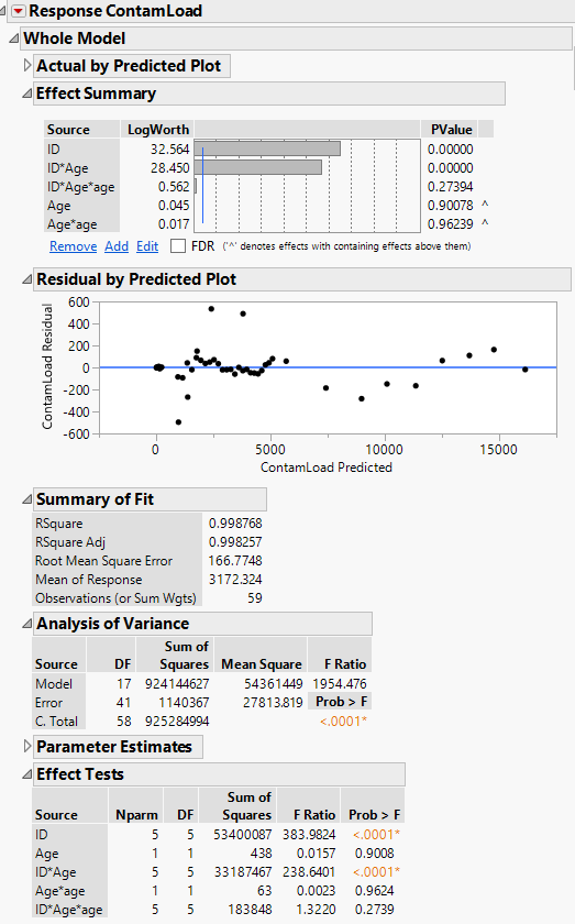

Mark Bailey,
I have included your suggestions and attached the output. I did have to duplicate the age column (Age-> age) to add the interactions. If this would cause an error please let me know if there are suggested method to properly add the model effects. Thank you again for your quick response.
ZW
You should not have to create a new data column to enter these terms in the model. Enter ID, Age, and ID*Age as before. Select Age and ID*Age in the list of effects. Select Age in the column list. Click Cross.
This way might also change the statistical results. Your way unnecessarily introduces collinearity. For example, Age is correlated with Age*Age, right? The collinearity will increase the standard error of the estimates, increase the length of the confidence intervals, and reduce the t ratio. The second way first centers the predictors (subtracts mean value), which removes this collinearity. Please try the second way and report your results.
Regarding the non-random pattern in the residual plot, I would not be too concerned. It indicates that there is bias in your model, but the magnitude of the bias, about ±200, for a response up to 15000 is quite a small amount. In fact, your R square is 0.999, so there is little bias. I think it can be ignored for your purpose.

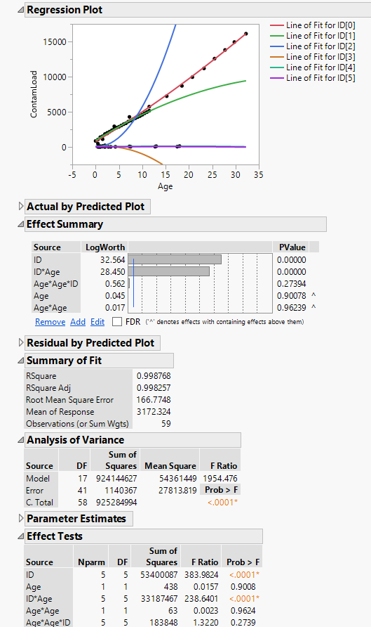

Mark Bailey,
Sorry for the delayed response. I have completed the model as requested. Thanks for the instruction on how to cross additional variables in the effects table. Below is the output with the requested effects. Thank you again for your help.
ZW
It appears that the best linear model includes only the Age, ID, and Age*ID terms.

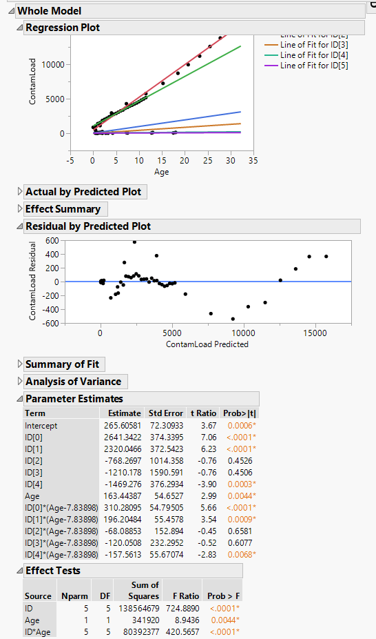

Mark Bailey,
Great! Returning to the orignal model, is there any part of the model to be concerned about? Also, do you suggest any post-hoc testing to identify which slopes are different from each other? I have included the original output with parameter estimates if that is of any use. Again, thank you for your help and quick response. ANCOVAOutput4.PNG
The observed pattern in the residual by predicted plot is initially alarming but after review we concluded that
  • you could not eliminate it with higher order terms (although maybe we should try age*age, age*age*age, and age*age*age*age to be sure),
  • it represents a small excursion from random error (compare magnitude of residuals to magnitude of response or examine R square), and
  • it appears to be a problem only for one ID level.
