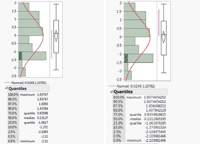

How do I change the number of decimals shown for a distribution plot?
Hi,
We recently moved from JMP 11 to JMP 13, and now the output of DoE looks different. In particular, more decimal points are shown than before (see screenshot). We want to avoid redoing all previous reports, so is there a way we can set the number of decimals in the distribution?
Any feedback is highly appreciated!

Hi,
You can change the format of the Quantiles values by right-clicking on the table, choose Set Properties, and change the table display to fixed decimals. The resulting analysis display can then be captured as a Script with the format change included.

Re: How do I change the number of decimals shown for a distribution plot?
Just to add to what Thierry has posted,  you can also try right-clicking on the column of numbers in the report and selecting “Format Column.”  From there, adjusting the Width value may give you what you’re looking for.
