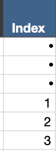

I know this is an old thread, but I have a question. This worked for me, except that when I try to create the index column, it is blank for the first ID. This is what it looks like.
Does anyone know what might be causing this?
txnelson
Re: How do I Transpose data from Long to Wide format?
Here is one approach to get what you want
If( Row() == 1,
	theVal = 1,
	If( Lag( :yourColumn ) != :yourColumn,
		theVal
theVal;
Jim
Hi there,
Where am I supposed to put this formula? In the same Index column? Do I need to change "yourColumn" to something?
txnelson
The formula I specified would be placed in the Index column.
The "yourColumn" needs to be change to the name of the column you what to increment the Index column's value when the column is changed.
