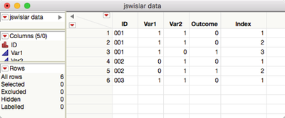

Here's the data that you presented in your first post in the form of a JMP data table.

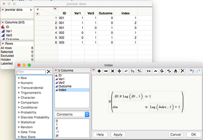

To this data we need add the Index column. @ron_horne used a different formula for his Index column but I like something a little more straightforward.
The formula above is:
If( :ID != Lag( :ID, 1 ), 1, Lag( :Index, 1 ) + 1)
In prose this says that if the ID value in the current row isn't the same as the ID in the previous row (i.e. Lag ( :ID, 1)) then put a 1 in the Index column, otherwise take the value of the Index column from the previous row (i.e. Lag (:Index, 1))
As you can see, the Index column in the data table now counts the rows within ID.
