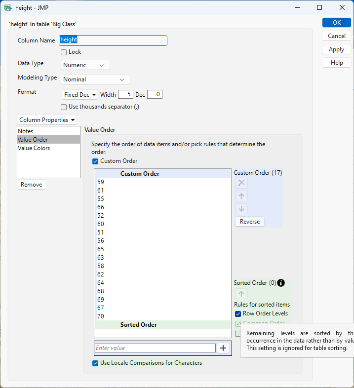

How do I KEEP the order of variables in a data set when graphing?
I understand that I can reorder by using the value ordering dropdown menu under column properties ( as indicated in other posts and videos). However this is needlessly time consuming for 50- 100 values that are already IN the correct order in the data set.  So I am just interested in keeping the data in the order in which it currently is.
Thanks so much for your help!

It's in the "Value Order" property window.
