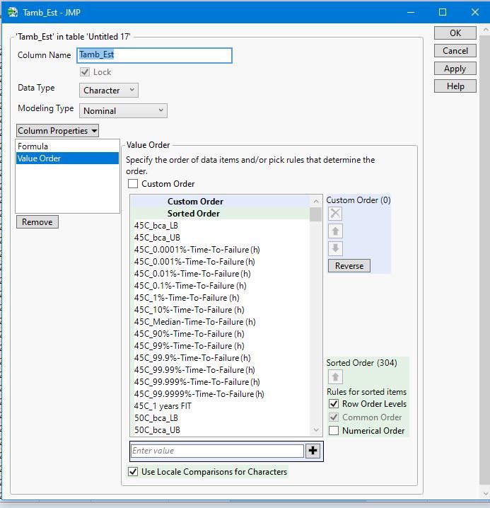

Re: How do I KEEP the order of variables in a data set when graphing?
I want to set the column properties for Value Order like below in the GUI, but I want to do it in JSL.
I figured out the syntax...
id_values = dts:Tamb_Est << get values;
dts:Tamb_Est << setProperty("Value Ordering", id_values);
txnelson
Great job.  I would like to add one fine point.
Your syntax does generate Value Order in the order of the values found in the current data table, it does not set Row Level Order.  The fine point is that if you would sort the data, and then perform an analysis or create a chart, the order of the values for your Tamb_Est would remain the same order as before the sort.  If you had set Row Order Levels, the data would be displayed in the new sorted order.

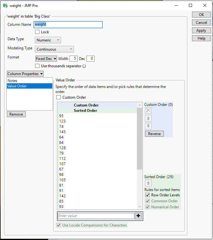

txnelson
  1. The structure of the Value Order/Row Order Levels column properties changed in JMP 15.
  2. The easiest way to figure out what you need to do in JSL for any of the Column Properties, is to set them interactively, and then to use "Get Property" for the column property you are interested in.  The results will show the input structure you need to use to set the column property.
  3. I took the Big Class sample data table and set the Value Order to Row Order Levelsorder.PNGorder.PNG
  4. I then ran this little script
    names default to here(1);
    dt=current data table();
    order = dt:weight << get property("value order")
  5. It showed in the log file the structure of the Value Order column property that needs to be used
    {Row Order Levels( 1 )}
  6. This shows that to have set the Row Order Levels for the Weight column it would be
    dt:weight << set property( "Value Order", {Row Order Levels( 1 )};
Jim
